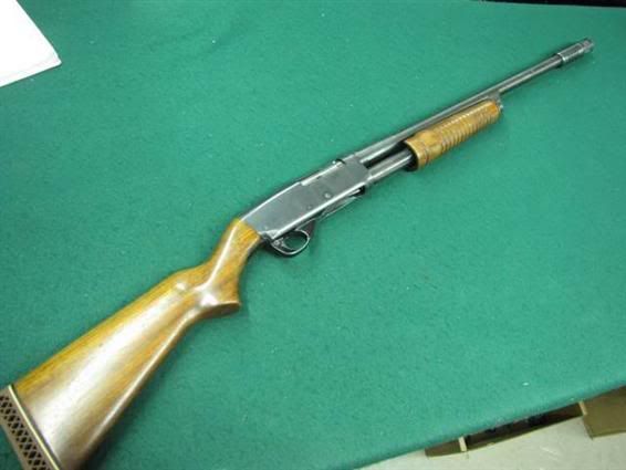

Although this isn't an AR15, I thought some picures of my latest project would be worthy of posting since I know there is some interest here in Vietnam era shotguns. This started out as a Stevens 77F that I bought for $130 on gunbroker; I worked on it as time permitted over the course of a couple of months. Details are below:
1. 77E buttstock, buttpad, and web sling from Sarco
2. 77E style forearm bought from gunbroker, finished with Minwax ebony stain and tung oil
3. I cut the barrel down to 20 inches and installed a new bead sight
4. I disassembled and parkerized it
5. I filled the lettering with white paint, then painted a tail on the "F" to make it an "E"... (this is the whole reason I was holding out for a model 77F... I tell myself there is nothing wrong with me)
6. The barrel band came from Bob at gun-parts.com
7. The 77E sling swivels came from Numrich gun parts
8. The aluminum trigger guard was anodized in "XM gray" by Victor at US Anodizing
9. I bought the paper hang tag from a guy on eBay
It was a fun project... especially since you can find parts dirt cheap if you keep your eyes open.
Pictures are below. The very bottom picture is the "before" picture.

Were there any parts in particular that were hard to come by?
jntmjt1  [Team Member]
12/11/2010 1:32:55 PM EDT
Originally Posted By cda97:
That shotgun looks great
No, these parts are a dime a dozen. The red buttpad used to be an issue, but Sarco fixed that.

John,if you don't mind me asking,how much do you have in this build? I would love to do a project like this.
12/11/2010 4:42:50 PM EDT
I have about $210 in it. That counts the paper tag. Minus that and it's right at $200. You can go higher or lower. As I said, I paid $130 for the shotgun, and that's probably your biggest variable. I've seen them go for less, and I've seen them go for more.

Did you put the U.S. in the side or was it already there?
I ask because in your last picture, the gun is set up like a lot of US marked full length and riot guns.
The black and white stripe stock with brown pachmeyer recoil pad, the weaver style choke. I've been trying to figure out if this is something the military did post war, or if it was just a popular thing to do with postwar guns.
12/11/2010 9:05:58 PM EDT
I hand stamped the "US" on it. I most likely will never sell it, plus I figured it can't be passed on as a fake since it's a model 77F (never used by the military).
12/12/2010 6:57:04 AM EDT
Originally Posted By Calgunner:
With shipping on all the small parts & the Park & Anno jobs too ($210.00)
I didn't include shipping and transfer fees in my original price... I was just talking about the gun and parts only. I try to maximize on shipping and order several things at once when placing an order (as I'm sure many others do as well). So I didn't count $5 shipping here and there exclusively to this project. As I mentioned in the original post, I parkerized it, so there was no cost there (I'm already set up for parkerizing).
Here's the approximate breakdown with shipping and the transfer fee:
Shotgun = $150 shipped
Transfer fee = $10
Anodizing = $30 shipped
Stock/sling = $25 shipped
Barrel band = I don't remember (about $15 shipped)
Sling swivels = I don't remember (about $10 shipped)
Forearm = $15 shipped (not required, depending on what your gun has)
Paper tag = $10 shipped (not required)
Approximate parts/anodizing total = $210
Total with shipping and transfer fee included = $265
My apologies for any confusion I created.
John Thomas

John,Any leads on the correct GI version fore end? I'm still looking for one.
2/12/2011 4:48:51 PM EDT
How bad do you want one? I found this one, but it's pretty steep... $35 + $3 handling + $? shipping.
