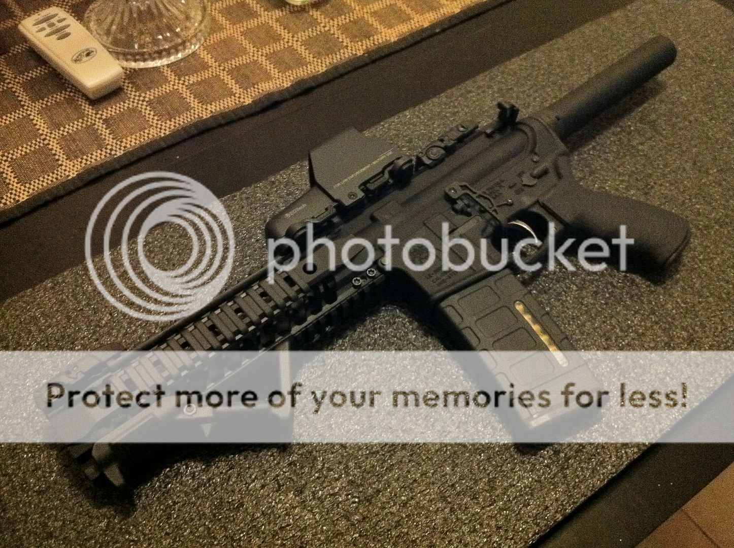

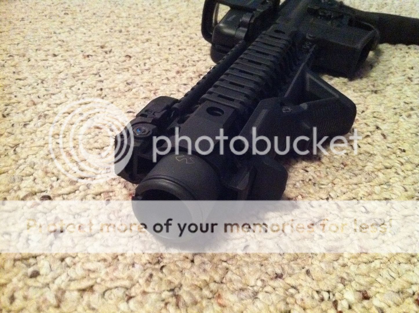

The Noveske 7.5" barrel, and the KX3 came in and everythg looks perfect. I hand tightened everything to see how it would look.
Here are a couple pictures.

Very nice!!! What are the other details of the build?

Ran into a small issue when I began installing the barrel & FS. The Barrel nut on the SAR is a slip fit for the rail and it is just slightly smaller then the KX3. So with the KX3 installed on the barrel the rail would not pass by. However I did figure out a solution, but already used my only crush washer, so I will need to pick up another one today. I need to install the KX3 on the loose barrel after the barrel nut and gas block go first, then feed it down the front of the rail and out the bottom so the barrel can be torqued down.
Obviously this set up isn't ideal for quick interchangability but I have no need for that, so it's all good.
RDTCU  [Team Member]
11/28/2011 1:48:58 PM
Or you can torque on the KX3 with a strap wrench. That's what I did to get it seated in my TRX rail.

oh man! That looks real good. I just decided to go 10.5" and these photos are the first bit of regret... but in true arfcom fashion I'll probably get both.
Great build!
