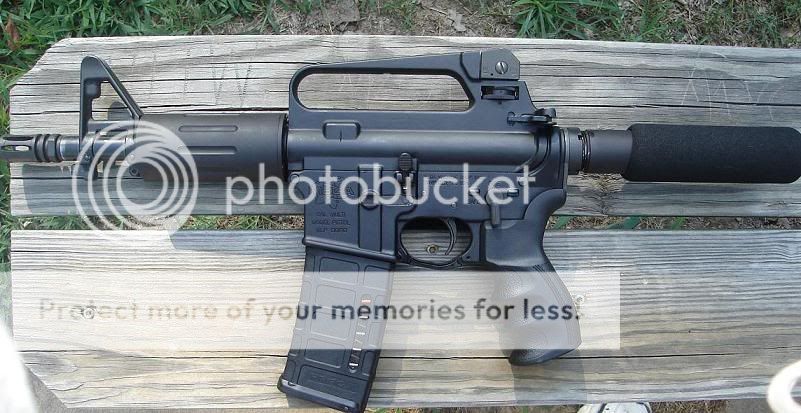

Ok so I have a DPMS 7" Kitty Kat upper and a RRA LAR-15 pistol lower. While shooting 55gr .223 ammo since I put this together it short strokes. I have heard that the Kitty Kat barrels are known for the gas ports being too small. The port is a #53 drill .0595. My question is what is a good port size to go with to fix this issue?

shadowcop  [Team Member]
7/30/2010 1:06:05 PM EDT
I had to have my KittyKat opened to .078. You may not have to go that big.
What buffer are you using?
What BCG?
I run a 9mm buffer with M16 carrier.
Port size from barrel to barrel can change. I have no explanation for it.
My Rainier 7.5" has a .056 gas port and has run 100% even with Wolf.
I run mostly 55 gr.

smithengineered  [Member]
7/30/2010 1:15:02 PM EDT
What BCG?
I run mostly 55 gr.
Im running the buffer that came with the RRA lower and the BCG is the one that came with the Kitty Kat. DPMS offered to take it back and "fine tune" it, but I still have not heard back from them on how much they charge....
7/30/2010 2:20:03 PM EDT
Well thats real nice of them, considering it's their product and it doesn't run.
Is it ejecting?
Check short stroking by putting one round in a mag, firing it, and see if the bolt locks back on the empty mag. If it does, it's not short stroking.
If you already know this, I appologize. Some have feeding and ejection problems, and think it's because of short stroking.
7/30/2010 2:33:11 PM EDT
Is it ejecting?
Dave
Thanks for the heads up I'll check it with one round next time I make it to the range. It is ejecting the round, but then I have to pull the chare handle again. I just assumed it's short stroking because the ejected casings are only coming out and landing approx 2-3' to my right.

OK so this is the email I recieved from DPMS:
Hello David,
Just to follow up with our previous reply.
That is normally a #53 drill (.0595”), however, with that short of a barrel, there is a very tight window of performance. It is not uncommon for fine tuning to go to a #52 (.0635”).
If needed, we can certainly test it and fine tune it for you.
Thanks,
Jeff Ostberg
QC/Engineering Mgr
DPMS Firearms, LLC
3312 12th St. SE
So it sounds to me from this email they know of this issue. I asked for a quote on how much they would charge to fix it, but still waiting on a reply.
8/2/2010 12:58:15 PM EDT
Ok they emails me back and said they can test it out and fix it at a rate of 55/hr for gunsmithing.... Not sure of typical going rates though.
FIGJAM  [Member]
8/2/2010 1:40:05 PM EDT
Put an o-ring on your extractor first.
8/2/2010 3:04:04 PM EDT
http://www.bravocompanyusa.com/BCM-Extractor-Spring-Uprade-Kit-p/bcm%20extractor%20spring%20upgrade.htm
Just the o ring? I just assumed this kit would help extraction issuses not problems with short styling. It's worth a shot for that price though.

FIGJAM  [Member]
8/2/2010 3:44:41 PM EDT
Your issue is not just pressure but also timing. The dwell time is so short that the bolt is attempting to remove the case before it's had time to contract fully. A lot of time what happens is the extractor is not strong enough and slips off the rim which gives the illusion of a short stroke. The other thing you can try is increasing dwell time which means heavier buffer, spring, carrier or a combination of the above. But sounds like your close enough that stronger extractor pressure is all you need.
Really, all you need is the o-ring. But if you get the Bravo kit, you can change out the spring, too, if you like.
For now, you can try going to the hardware store and picking up some #60 o-rings and give them a try. They aren't the best material but will last for a while until your other kit comes in. You'll want the extractor upgrade regardless if you end up increasing your port diameter.
8/2/2010 4:11:42 PM EDT
Upgrading the extractor definetly won't hurt. I would still like to know if the bolt locks back on an empty mag. If not, it's short stroking.
8/2/2010 6:08:51 PM EDT
Good info thanks! I'll try this out before I fork out 55/hr.
8/2/2010 6:25:42 PM EDT
Is it ejecting?
Dave
You stated it was ejecting, so ejection is not the issue.
An extractor upgrade will help insure ejection but will not solve short stroking. Extractor upgrade is always a good idea to me. I have it in all my rifles.
Dwell time is an important factor in getting a 7.5" to run well. I also use a full auto carrier and 9mm buffer. It increases the dwell time which gives the case aextra nano seconds to contract.
This is where a lot of rifles have problems running steel case. Steel case takes longer to contract than brass.
Dave
My 7.5" runs Wolf without an issue.
8/2/2010 8:42:17 PM EDT
Yes you are correct it is ejecting. What weight buffer should I use? RRA is rated at 5.6 Spikes is like 4.3 oz. Also should I worry about ever trying to shoot heavier grain ammo with a heavy buffer? Seems like more power with more mass/ heavier buffer may do damage to the BCG??

DaJester  [Member]
8/3/2010 6:42:54 AM EDT
I was given this advise by iNuhBaDNayburhood (he's on this forum) and it was a tremendous help. I ended up upgrading the buffer and drilled the gas port 1 size up on my Kitty Kat. Read this over, hope it helps...
Whenever I deal with short-stroking, the first things I do are:
1.) Check the bolt, carrier, gas tube, gas block, and gas rings for proper fit & tightness. Test Fire with low-pressure ammo (WOLF).
2.) Replace gas tube & gas rings with a new ones. Check tightness. Test Fire with low-pressure ammo.
3.) Replace muzzle device with a Noveske Flaming Pig. Test Fire.
4.) If STILL short-stroking, I'll take off the gas block, and measure the gas port size in the barrel, and shine light into the gas block - to ensure it's not plugged/blocked. If you see light escaping, it's almost certainly a fine gas block - the problem is likely the gas port size.
5.) Install H2 Buffer, and if gas port is out of spec, Drill the gas port one increment wider. Test fire.
6.) Repeat Step 5 until functioning.
I'm not 100% sure what your specific barrel's gas port should be drilled to... There are FIVE main considerations that need to be measured:
1.) Distance to muzzle (Crown of barrel, not end of muzzle brake/flash hider).
2.) Diameter of the barrel where the gas port is drilled (Usually 0.625" or 0.750").
3.) Length of Gas Tube (Carbine? Mid-Length? Rifle? or Custom?)
4.) Length of Barrel.
5.) EXISTING diameter of gas port.
Many are surprised to learn that even Carbine & Rifle length gas systems can both suffer from short-stroking due to improperly drilled gas port sizes.
The easiest way to try fixing it is to add the Noveske FH, but even that may not work reliably... Another muzzle device some try to add is a .223 caliber Krinkov AK style muzzle brake, which also has a small chamber for gas expansion, but this doesn't work as effectively for gas cycling as the Noveske Flaming Pig. Krinkovs were designed with incredibly short barrels, and that was the Russian's solution to their short stroking problem with their short-barreled AKs. It may not work very well in an AR though.
Depending upon the above measurements, it could likely (but not certainly) require a diameter anywhere between 0.081" to 0.094". That's a WIDE range of potential gas port sizes, and the best way to do this with HIGH certainty that you're not over-drilling your gas port is to send your upper receiver assembly to an AR-15 Armorer, or do it yourself.
The only things you need are:
1.) Small drill press with Vise, or Handheld power drill (with workbench vise). With variable speed (either setting (drill press) or the ability to squeeze the trigger lightly & drill slowly)
2.) Oil for drilling.
3.) VERY GOOD drill bit set with 1 Gauge to 60 Gauge drill bit sizes.
4.) (Optional) Hammer & Small diameter Pin Punches.
Honestly, there's not much to it other than making a few measurements above, and most notably checking the existing gas port diameter... The MOST ACCURATE way to check the diameter of your gas port - is with Drill Bits. The proper set of drill bits to open up a gas port can be purchased from Northern Tool:
http://www.northerntool.com/shop/tools/product_200326944_200326944" target="_blank">http://www.northerntool.com/shop/tools/product_200326944_200326944
It has Gauge sizes 1 to 60 (for drilling gas ports or small precision holes), and it also has A through Z gauges, and standard "English" fraction-inch sizes.
As a certified AR-15 Armorer, this is the same bit set that I use for drilling gas ports - both in AR-15's and AK-47 custom builds, and a few belt-fed weapons. There's not much to it, really... With the above measurements you can closely calculate approximately how wide the port should be drilled, but that's still just an approximation, and the best way to ensure reliable results is by Trial & Error.
1.) Measure existing gas port with drill bit. Turn the bit around, put the shank-end of a drill bit into the gas port, starting with the 54 Gauge drill bit shank, and working your way up toward 46 Gauge... One bit will probably get very snug, and be difficult to enter, and the next won't fit. The previous one that went in - that's the diameter your gas port was drilled to...
2.) From there, it's really just trial & error!
Although, your barrel should be drilled anywhere between 46 (0.0810") and 42 (0.0935") gauge sizes, you DO NOT want to drill it any wider than is necessary to cycle the least-reliable ammunition which you intend to fire regularly. I'll admit, I DO use Wolf polymer coated ammo as a low-pressure benchmark for the guns I work on... A gun should reliably eat all SAAMI spec ammunition, including Wolf, although I DO NOT recommend its regular use - a reliable gun should be able to cycle with it.
SO, how do you make sure you don't over-widen your gas port? Trial & Error is the only way to be sure.
I'll go through an example of how I've done the last two AR-15's:

HeavyDutyDude  [Member]
8/15/2010 2:29:41 PM EDT
I'm using a 7" kitty Kat barrel as well, the gas port is as delivered. I'm using a Midwest industries gas block. I played a bit with loads and I'm sold on 23.8 grains of Accurate 2015, 55 grain Mid-South soft points. LC brass with crimps reamed, and Wolf 223 primers, it shoots flawlessly! I'm using the Spikes Tactical Buffer tube with the stiff Spikes buffer spring and HEAVY Spikes 135 gram buffer (an OEM carbine buffer weighs 95 grams)
I tried faster powders to help with the fireball, starting with BlueDot Contender loads and kept going slower until hitting on H4198 and I shot H4198 for awhile but it would try to double feed about every 20-30 rounds or so. Installing a Noveske Pig as it's basically a funnel increasing the gas pressure that the gun needs to operate and was a HUGE help, plus chilling out the fireball.
Again, before redesigning the gun, try a Spikes Tactical Buffer assembly and load up some of those 2015 loads, I think you will be pleased!
I've got roughly 600 rounds threw the pistol and I'm in the process of loading 1000-1500 rounds of that 2015 load, I'm that pleased with it and it shoots pretty good in carbines and rifles as well. Per Sierra AR .pdf you can go as hot as 25.2 grains of 2015 but since i'm using military brass I down load a little. 23 grains would shoot but wouldn't catch on the bolt catch on the last round. 23.8 grains shoots perfect.

http://i980.photobucket.com/albums/ae285/HeavyDutyDude1911/DSC04220sm.jpg
Sweet gun, but yes I do not have the ability to load rounds. A am debating on trying to argue the fact that I bought the barrel 9 months ago new from a supplier of DPMS and see if they can help me out any with the price of gunsmithing to open the gas port, and order a new FH since that seemed to help out a bit.

David, I wish you all the luck on your pistol. I'm sorry you don't reload as I find as much enjoyment finding that just right load for each gun as much as I enjoy shooting. In fact I find I shoot to test loads more than I shoot to just shoot.
As a note I found that the 14" barrel contender guys use Blue Dot in their 223 loads, Blue Dot is 357 Magnum powder and it's designed to do everything it's suppose to do with in a 6" barrel. Even still it's a 2900 fps load and I then discovered that varmint shooters with 24" heavy barrel bolt guns like it because they can shoot at a prairie dog town all day long (like 500 rounds) and not have to swap out guns or let it cool down. (Something I can't do with my 220 swifts) Less powder means less heat. Anyway I tried like hell to make that Blue Dot load function in my AR pistol, same deal as you the bolt would short stroke. I played with Wolff reduced power buffer springs, common carbine 95 gram buffer, even taking it apart and removing weights, clear to trying it empty. NO-GO, the gun requires GAS to operate.
You could have a burr in your gas port hole, or even in the gas block itself, I would explore that system, because in stock form your gun should function with mil-spec ammo. along with fresh gas rings make sure they have a drop or two of oil on them. Good ole cheap black box Wolf ammo shot fine when I was putting my pistol together but with a A2 flash hider I had about a 55 gal barrel sized fire ball in front of me. Fun for a magazine, but then got old quick.
Here is a picture of how my pistol looked when assembled for the first time.
I hope you find the answer, It's something simple.

Shadow Cop, we're all good. I have a bunch of guns and I reload for most of them, but I'm not going to jump on a box and call myself an expert, I'm just an enthusiast. I built my AR pistol mainly because I had left over parts from other guns, the upper on my pistol started out as a DPMS DCM/CMP National Match upper and one trip to the range was all it took for me to realize that iron peep sights, 600 yard targets and my 45 year old eyes was a mistake. That gun now wears a DPMS Low-Pro upper and a target scope. And is a pleasure to shoot from the bench.
Then with extra parts in the safe I thought it might be fun having an AR pistol, so I put one together. I will admit it was a challenge making the thing shoot to my satisfaction. They aren't really beginner guns. And to my satisfaction means hand loads. But they still operate with store bought ammo and hopefully David will find the ailment with his.
My Kitty Kat barrel wasn't machined for the end cap, it came with the front sight tower installed and there was no room for a forend cap. In my first configuration I had .025" machined from the back of the sight tower so I could fit a round forend cap and have the sight tower pins line up. All to give the gun a more finished look. So if David has a clamp on gas block and is using a forend cap like I did the gas block might be covering half the gas port hole. Toss the end cap and push the gas block on as far as possible and give it a test fire, it might be something that simple.
HDD
