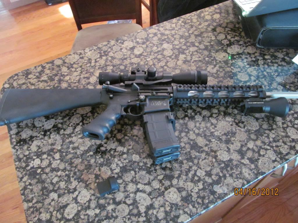

 Ordered everything for my next build, Wilson Combat .204 Ruger PICS UPDATED FINISHED PICS
turb06le240  [Member]
3/24/2012 9:32:04 PM
I was given 3 ammo boxes full of 204 ruger, I like the round, but dont own any rifles in the caliber so I was thinking about getting another 700, until I did a little research and it seems people like the ar15 204 so I figured I will try it...
Ordered a wilson combat fluted stainless 18" mid length 204 barrel, also got the low pro gas block from them.
Ordered the gas tube, YHM diamond middy rail, and upper receiver from SAA
Ordered the Upper parts kit from bownells {no one else has them, had to order everything separately}
And from Midway I got the Daniel Defence BCG, BCM charging handle, and an A2 stock
I while back I bought 2 S&W MP15 lowers, that I had plenty of parts to complete them with- I used a rra 2stage match trigger, kns antiwalk pins, oversized safety selector, Oversized td pins, troy trig guard, and an oversized mag release.. I need to buy a grip for it since all I have it the milspec plastics, which will work until I make up my mind... I assembled some of the lower tonight, so now just a waiting game for the parts to get here... After my discounts the upper is going to cost me about $670 shipped....

Here are the first pics of her, not done but with whats come so far its as far as I can go... Got the lower built..
SW lower, rra trigger, hogue grips, kns antiwalks, oversized safety, oversized mag release and pull pins, troy trig guard, and Tact link, Also got the DD bcg, bcm handle, and scope in Leupold mark AR 4-12x40mm, and the mount is a burris pepr {sorry not in the pic}... Looks like everything will be here by the end of the week, I will update after then...

OK, I have been busy so the parts sat there untouched for a few days but I finally got her finished up...
I took it to the range and ran some cheap 32g rounds through it and it shot amazing, no hiccups, very little recoil, and seems to group the 32's around .65 avg, my best group had 3 pretty much touching {with nosler trophy ammo} but only had 8 rounds of that stuff, one of the guys at the range gave me, he said its almost $2.50 a round so I wont be buying that stuff, but it shoots well...
I ran a total of 48 rounds through it and Im very happy with it, I want to say this is the most accurate ar I own, but Im not positive because my 556 bull brled gun shoots well too... I ran 100 rounds through that on the same range visit...
I was also impressed how fast I got this one zeroed in, I put a burris dot on the top of the burris pepr mount and the scope is a 40mm leupold mark ar, they both hit the marks after 3 shots, but I was adjusting them at the same time, I had her strapped in to the rest... I also through a streamlight on there for good measure...
Total spent with optics, light, and bipod {not in pic} is $1980 even... I dont think thats too bad considering half of that was from the light, bipod, and optics....
Heres the pics...

Ive been thinking of adding a 20cal to the vermin line up.
A quarterbore can play too
http://i23.photobucket.com/albums/b371/scatterbrains/2012-03-17_16-13-39_554.jpg
I dont see an advantage to the 20 practical over the 204, maybe because there is a lot more 223 brass around, it makes sense to reload it, but the 204 being a factory load makes more sense to me, Ive looked over the #'s and their ballistics are very similar... Ive shot both and I dont see a huge difference, I guess personal preference would weigh out on them to, I prefer to be able to buy ammo in a box over not...
scatterbrains  [Member]
4/22/2012 12:11:02 PM
Yeah off the shelf doesn't matter to me LOL, but all considering they are pretty damn close it seems.
seems the 20P will be in my future then.
