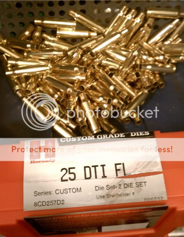

A 6.8 case necked down and shoulder blown out to increase case capacity.
I have a 25 DTI scheduled for delivery on Friday, so I will be sure and post a range report. Any one hear about them or shoot one of the DTI Line?
I'm planning on 75gr sierras for coyotes, and an 80 gr Barnes for deer. Velocities should be 3200 and 3000 respectively. Should be a fun round.
Some sized Brass,

Case prep is as simple as running 6.8 Brass into the custom hornady 25 DTI sizing Dies and then loading. The shoulder is blown out just a little to 30deg the first time they are fired.
I measured 10 new sized cases after resizing and all were Between 1.678 and 1.681. Trim to length is 1.676 I would say that no, the case does NOT noticeably lengthen when resizing. At least not enough to need to trim.
