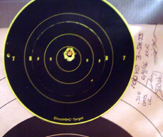

captrichardson  [Team Member]
2/9/2007 10:28:04 AM EDT
I have a "semi-stock" DPMS LR-308 (replaced trigger & stock),
The target below was shot at 100 yards, basically 3 shots in 1 hole.
My 300 yard groups for that day were around 2", with some of them even being around 1.5".
IMHO, that rifle can flat shoot!
To be honest, my Remington 700 now stays in the case, and pretty much all I shoot is that LR-308.
If you are going to go long range (600-1000), I would definitely get a "Bob Sled Mag" and single load each shot by hand. I have shot multiple sub MOA groups from 100-300 yards feeding the rounds out of the mag, but it is possible to "ding" a bullet in the auto-loading process, and that would not be good if you were trying to shoot out to 1,000 yards.
If you are looking for a "dedicated long range shooter", you probably will have a hard time beating a "custom built bolt gun". However it is really nice to be able to drop a mag in and pull the trigger repeatedly without having to cycle the action, and still be able to shot sub MOA.
Good Luck,
"Capt Richardson"
