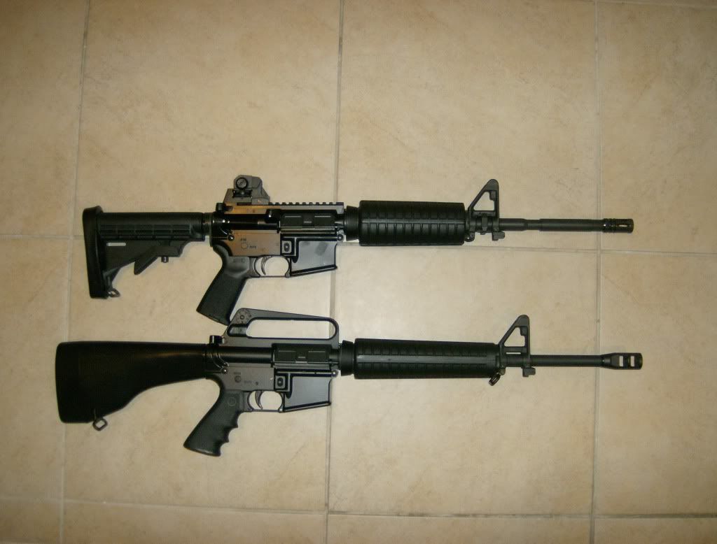

I need help.
Today I was helping a friend build a complete rifle. The upper is a flattop with a 16" RRA barrel (heavy under the handguard area) and we're finishing it with a Daniel Defense 9.5FSP rail system - but we had a big problem.
Once assembled we quickly noticed that the about a full 2" of the gas tube was fully exposed and not covered by the rail system. MY rifle that we had sitting on the bench only had about a 3/8" area exposed. We quickly discovered that my friend's barrel front sight tower location was a full 2" farther forward than on my 16" M4 lightweight barrel. WTF!? I have never seen this difference in sight tower location in a 16" barrel.
Is there some other 16" standard that I am unaware of (apparent so)?
Help.
CMOS.

It sounds like you have a 16" barrel with a mid-length AR-15 gas system. If your gas tube winds up where it's supposed to in relation to the upper receiver then you fortunately got the right mid-length gas tube, but your rail system is not right for that configuration.
ETA - Carbine gas 16" barrel (top) and mid-length gas 16" barrel (bottom):

That explains it. We wanted to build a true M4 upper, not a mid-length. The DD 9.5FSP rail system is for a true 16" M4 barrel. We'll have to see if they will exchange the barrel for a real M4 type.

MMcfpd  [Life Member]
4/7/2012 4:00:51 PM
Originally Posted By CMOS:
How do I specify the correct 16" M4 barrel when I order one?
Specify a carbine gas system.
