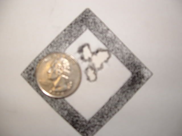

rock71  [Team Member]
1/28/2012 7:11:09 PM
My Precision Operator was pretty accurate.
10 rounds, 75 grain Hornaday, 100 yards.
