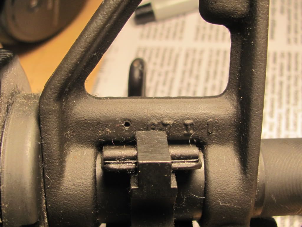

clev  [Team Member]
7/22/2010 1:34:50 PM EDT
Thanks for the help guys. I also meant to tell you is a a heavy barrel also. Here are some pics I took.
I never even noticed some of those markings, lol
Can someone tell me what they mean?
Molon  [Team Member]
7/22/2010 1:40:06 PM EDT
http://i651.photobucket.com/albums/uu234/clev_01/IMG_0350.jpg
http://i651.photobucket.com/albums/uu234/clev_01/IMG_0351.jpg
http://i651.photobucket.com/albums/uu234/clev_01/IMG_0353.jpg
Dude, that is not a Colt M4. Can you post a pic of the entire barrel with the handguards off. It's likely a Colt 6721 or possibly a 6922, also sold as a AR6920-DC upper.

i concur with the 6922 since it has a FH and the side sling swivel

Yep, my barrel looks like the 6922. I bought the AR about 11 years ago and then ordered the complete upper about a year later. I ordered the upper out of a ShotGun News magazine. So is my upper a Colt? Also, what makes a M4 diffrent from what I have? Is mine shit? lol...
altopwescap  [Member]
7/22/2010 3:16:26 PM EDT
Given the additional information it is a Colt M4 and certainly is NOT shit. How does it shoot? Round count? The "C" is the Colt maker mark, the AF just means that they used a forge blank made by Alco Forge. Between the delta ring and the ejection port there should be two small faint proof marks. A "VP" in an inverted triangle and a "C" in a square.
An M4 upper has a 14.5" barrel with a 1:7" twist. Your 6922 /AR6920-DC has a 16.1" barrel with a 1:9" twist. Upper conversions such as yours, do not usually have proof marks on them. Normally, only complete rifles do. I owned two of the 6922/AR6920-DC uppers and they were both 100% reliable. Accuracy was as expected for a chrome lined, NATO chambered, governmnet profile barrel. It's a fine upper and should serve you well.
