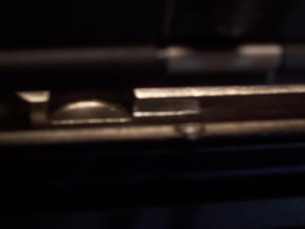

 Need lots of feedback on this thread... P-415/416 issues anyone?
prionic1  [Member]
2/16/2009 3:56:17 PM
I started a thread titled "Rather dissapointed" that you should read. Link http://www.ar15.com/forums/topic.html?b=2&f=206&t=170064
I'm asking any owners to post about whether or not they are having any issues relating to the other post. Yes, no? When did you buy? Barrel length? Semi / Full Auto? Suppressed? How many rounds have you shot?
Also, .308 owners. Are you having any issues related to this as well?
Mine is a P-415 16" barrel.
Purchased in Nov '08
About 400 rounds max
Semi Auto
Non Suppressed
And of course, yes, I have "the groove" in the upper. Hence the begining of the post.

Mine has the same wear/groove as your's that I posted in your other thread.

I have the same wear and chrome flakes inside my receiver. I don't really see it as a problem as of yet. But, I would like to know that this is not a problem in the future.

had feeding issue in the beginning and the now the groove in the upper.

only about 240 rounds have been fired through this upper and I have the same wear and chrome flakes inside my receiver.
I've had perfect reliability and great accuracy from this upper. I've fed it 77gr federal TRU, XM855 NATO, XM193 NATO, 55gr soft point Wolf and 75gr steel-cased Hornady practice ammo and I intend on buying a suppressor for it (for me that is the whole purpose in buying a piston AR and this can only serve to add to the wear I'm seeing in the upper receiver). If the metal flakes do not stop by 500 rounds I'm going to assume the gun is on its way towards destroying itself and eating itself apart. I'm going to experiment with a 9mm buffer and see what happens.
The chamber, bolt, bolt carrier and all other internal parts look perfect and new. I can only assume that all the metal flakes are coming from "the groove" being worn in around the cam-pin area in the upper receiver. I do not understand how this happens??? Doesn't the cam-pin have to be completely rotated and out of the way of the upper receiver before the bolt could have unlocked and released from the chamber??? HOW DOES THIS GROOVE HAPPEN???

That's what I thought too but the groove is there.
Sharps74  [Member]
2/17/2009 5:43:11 PM
And you would think this tearing at the upper receiver would apply way more then enough resistance to jam the gun but my gun isn't even phased by it. Not even with the weakest, most low pressure ammo I can find to feed through it.
We really need to hear from some folks who have a much higher round count. 2000+ rounds, is anyone still seeing metal shavings and increasing wear in "the groove". Or is there hope? Will these guns break or break-in???

My upper has well over 2000 rounds through it. I do have quite a grove worn into my upper, and I will be watching closely to see if it gets bigger. I did notice a few chrome flecks in gun, posting some pics
Hard to photo area BTW!

Yeah, it wasn't easy getting photos of this stuff for me either. I wish I could have used my nikon 35mm but that is such a hassle... I never use that thing anymore. Digital is the way to go nowadays. So I had to struggle with my sony point and shoot, but I feel that my photos pretty clearly express my concerns...
I have sent my upper back to POF. They received it last Friday according to the tracking number. I'll keep everyone posted about how this issue turns out.
I will say this though. Although it is weird that "the groove" is "created" aside from the apparent design, having heard from a few people that have a few thousand rounds through their's makes me feel a little bit better about issue. I felt that I had the one POS with a defect but it seems that it is a common issue (perhaps) and doesn't affect the performance of the hardware. If that's the case then so be it. I'm sure that I will put enough rounds through mine within the warranty period to find out if it is a true "defect" or not.
Anyways, I'm waiting to hear from POF about this and see what they say. I'll keep you posted.
Thanks for everyone who is sharing their experience on either side of this fence.

Checked mine and found the same wear pattern about 1/4 the size of the one in your picture.
Like the other post, if the cam is supposed to rotate out of the way what is causing this?

I also have the groove shown in the pictures, about half the size and growing.

My main concern is whether or not this is normal. Some of you are stating that the older POF's did not have this issue? Has anybody had failures with their rifles?

non of my old one showed any kind of wear . this recon looks like the reciever was hacked up with a chisil and it shoots just like a muzzl loader. think pof knows they have a problem that is why the are staying away.

If I am reading this correct, the issue is the bolt?
RI0T  [Member]
3/10/2009 2:27:07 PM
Yes it appears the issue is with the bolt.
At least in that case.
Makes a lot of sense, and the guy obviously did his home work.

MYSTERY SOLVED!!!!!!
Guess what boys??? My LWRC M6A2 upper has the same groove chewed out!!! So instead of going to bed, I just got done studying this issue for the last hour and here is what I found. When the bolt carrier moves rearward and the bolt unlocks, the cam pin is not making it all the way to the end of the grove in the bolt carrier. Therefore, the cam pin is cocked slightly outside the protection of the carrier key so it makes contact with the upper in the grove spot before aligning fully and traveling to the rear without rubbing. Do this: crack the upper open and pull your locked bolt back with finger pressure and then remove the bolt. Looking down at the top of the bolt, you will see that the cam pin is not aligned with the key but hanging outside of the key slightly where it can chew up the inside of the upper on its way rearward. This really seems to have to do with the way bolt carrier lugs line up with the chamber lugs. The carrier is allowed to unlock before the bolt and cam pin are pulled completely forward, that is, before the pin makes it all the way to the front of the groove in the bolt carrier, leaving the pin cocked to the left slightly inside the upper where it is hitting the inside of the upper on it's way back before being aligned in the groove. Once aligned by smashing into the upper, it doesn't seem to be wearing anymore on it's way back. However, I see it continuing to wear a groove in the upper all the way to the rear of the travel, although the depth is only limited by the distance it is sticking out from behind the gas key. So you see it could potentially wear farther and father back into the upper but it is not going to keep going deeper and deeper into the metal. It is only going to go as deep as distance the cam pin is not aligned in front of the gas key. Make sense????
Who has a DI gun they can check??
Islandboy671  [Member]
3/24/2009 7:01:29 PM
That does make some sense. I guess with DI sytems, gases being vented from the bolt carrier and gas rings keep the bolt in the foward position after each shot before it starts to rotate towards the rear of the receiver. We're talking maybe hundreds or thousands of a second.

I get my new JP bolt + cam pin this Thurs, and I'm testing it out this weekend. I'll let everyone know what happens....
BTW, has anyone tried running with the gas rings installed on the bolt? Maybe it's enough resistance to prevent the bolt and cam pin from knocking around when the carrier is pushed rearward.

I think that's exactly what's going on. There is a fraction of a millimeter between the lugs being unlocked enough to withdraw vs full bolt forward extension. I think the gas pushed it all the way home so this was never an issue for DI ARs, and piston driven ARs just unlock the lugs enough to start the BCG rearward and that's it - the bolt is not rammed home straight by any gas. The solution is a trimmed or some sort of low profile cam pin top, or a carrier cam pin channel that is more angled to ride the cam pin to full bolt forward position and then pull the bolt rearward. I don't think the worn groove on the upper receiver with get any deeper just longer.

so it seems that grinding your cam pin down would be an acceptable solution?

I wouldn't worry about it but I would break the gun in really good and make sure any metal that has flaked off is thouroughly cleaned. Also, make sure you check your trigger and maybe even blow it out with some compressed air.
There are several guys with DI guns reporting the same groove, which means their bolts are unlocking from the lugs too before the gas has pushed the bolt all the way out of the carrier. Like I said before, it won't get deeper, just maybe longer for a time.
glock9mm  [Member]
3/29/2009 1:04:46 PM
POF 16" upper on DPMS lower.
Appr. 400 rounds thru it. Purchased upper in 2008.
Exact same groove as everyone else. No other issues, though.

SoCalTrojanSoldier  [Team Member]
3/29/2009 1:34:35 PM
Due to this thread I sent a this question to LWRC and the following is the question and the reply (edited to remove names). Joe has been my contact there at LWRC for some time and has always provided outstanding service. I have several DI (S&W x 2,and a Colt). I also have a POF, same thing. I would tend to believe that LWRC and POF would have let us know it there was a danger or catastrophic failure.:
Question:
From: Jason
Sent: Friday, March 27, 2009 3:20 AM
To: Joe Devens
Subject: Groove in upper
Joe,
I'm sure this issue was addressed in the LWRC forums but I couldn't find it. After reading about a groove created by the cam pin in a AR15.com forum thread, I checked to see if my LWRCM6A2 had the same problem and it does. There is a picture in the following link: http://www.ar15.com/forums/topic.html?b=2&f=206&t=170353
A groove is forming in my upper that looks exactly the same as the one pictured in the thread.
Is this dangerous? There are metal shards in the lower and in the upper.
Has there been a fix for this yet? How can I prevent this?
I apologize for asking but I figured I'd go to you due to the many varied answers.
Thank you.
Jason
REPLY:
Received: Sent: Friday, March 27, 2009 9:21AM
Jason,
The groove you are seeing is completely normal. And is common among even DI rifles. It is a result of the cam pin acting on that surface during the feeding operation. It is not dangerous and it will stop eventually.
Joe Devens
LWRC International
815 Chesapeake Drive
Cambridge, MD 21613
410-901-1348 PH
410-228-1775 FX
3/29/2009 1:38:40 PM
Originally Posted By Mrs_Esterhouse:
http://www.ar15.com/forums/topic.html?b=2&f=206&t=170064&page=3
?? My bolt on the LWRC has gas rings. Does anyone NOT have gas rings on their pistons?
