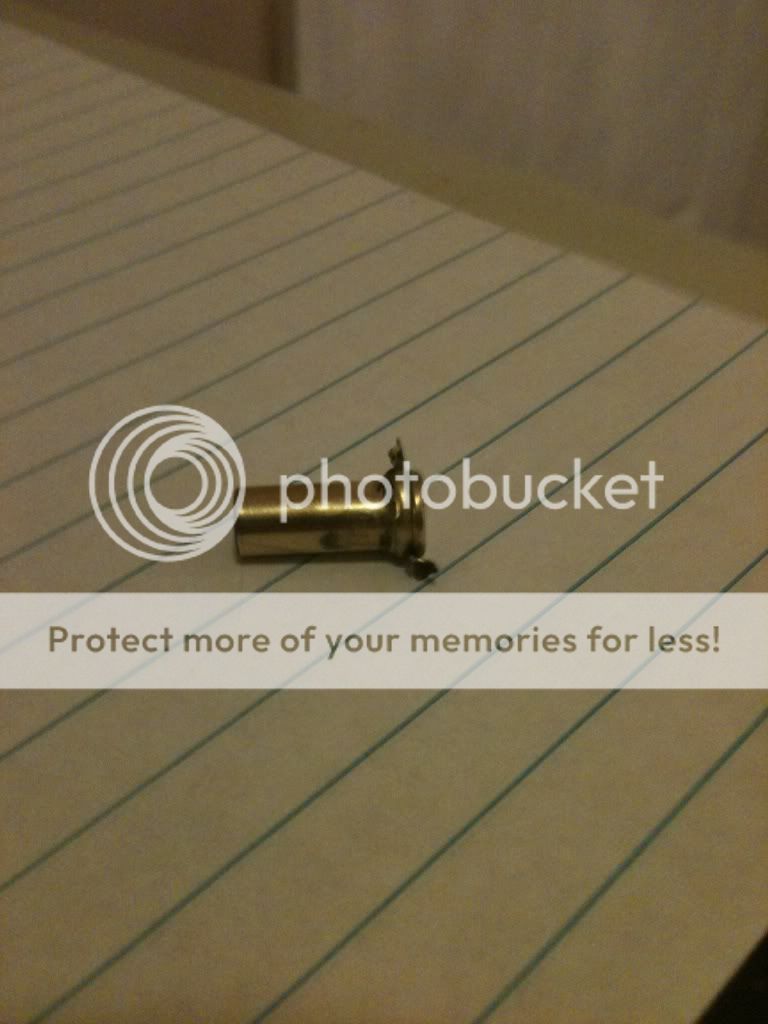

I have a dedicated upper with 2-3000 rounds through it. Twice I have experienced ruptured cases.
The first occurred with CCI Mini Mags and it blew the entire rear of the case off.
The second occurred today with CCI Blazers. The case is intact but severely ruptured.
It is obviously firing out of battery, but what can be done to remedy the situation?
shadowcop  [Team Member]
12/12/2011 9:55:33 PM
Out of battery discharge usually occurs due to build up in or around the chamber, keeping the round from fully seating. CMMG recommends buzzing the chamber frequently. Use a bore brush chucked in a drill with oil on it. Run in the chamber until warm. Don't go into the rifling.
Dave N
AR-180  [Team Member]
12/12/2011 10:00:43 PM
Definitely firing out of battery. I have experienced it with another brand. Try the technique listed above.
SpringArm  [Team Member]
12/12/2011 10:06:21 PM
Thanks Dave. I'll give that a try.
The first rupture occurred during my first session with the upper and within the first 50 rounds.
I figured it just needed a little break in.
Today the rifle should be broken in, but the chamber is very likely dirty.
I have fired about 30 rounds of CCI total through it and had 2 ruptures. It shouldn't take too many rounds to see if buzzing the chamber helps.

I "buzzed" the chamber as suggested and it seems to have worked. I fired some 250 Blazers without issue. I also miked some CCI and Federal casings fired from the CMMG upper.
The CCI's casings are slightly longer and the bullet has a significantly longer bearing surface. I suspect that as long as one shoots the same brand of ammo, these issues will occur much less often.
Firing cartridges that have longer casings and/or longer bearing surfaces after firing shorter ones may cause issues sooner than expected. (reminiscent of the steel case / brass case issues in .223)
The CCI Blazers group significantly better than the Federal bulk packs. I'll continue to experiment and post results. I plan to fire Blazers until another ruptured case occurs (or 500 rds...whichever comes first)
Thanks for the advice.
