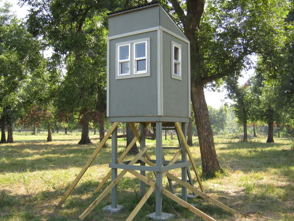

I built this blind for around $200, with some free stuff I picked up laying around. I think I got some of the 4X4's and the shingles for free.

You can't see it in my pic, but the 4X4 legs have 2X4's connecting them down at the bottom to serve as something to anchor to. We buried the wood a foot or so in the ground, so that the connecting beams were right on the ground, then took 4' pieces of rebar and pounded them in by the corners and then bent them over the 2X4's. It's been standing two years now through some pretty good winds. We did the same for our last one, but a flood took it.
