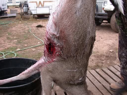

Winchester 150-grain Power Points haven't failed me yet. Fast, hard hitting, accurate...what more does one need?
It's a damn deer, not an armor-plated zombie. Put a .30 bullet into the vitals and psyche yourself up for the body drag.

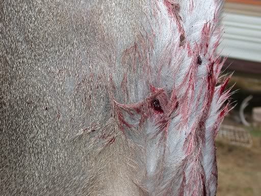

Have you ever witnessed how these bullets perform on thin skinned game such as white tail deer?
I shot 2 animals with the 168 grain match bullet from sierra and will not use them as my first choice ever again. One went chest to ass on a 5 point bull elk and did not musroom at all small dent is all. Second on a large mule deer shoulder exploded like a gernade. I am not saying that ether animal did not die I just think that any hunting bullet is better for hunting. PS I LOVE CHEAPO COR-LOKTS!
