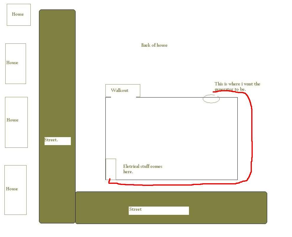

Papi4baby  [Team Member]
1/19/2012 12:10:54 PM
Originally Posted By nate1865:
Install an external power inlet box now and run it close to your breaker panel, even if you don't have a subpanel installed.
That's one dilemma i am running into.
1/19/2012 12:12:11 PM
I am thinking something around 10K for power. I know i have to find out what it will take to run everything by actually looking at all the appliance labels and what not.
Builder did say he would run the line to the back of the house, but he recommended close to the panel due to electrical. My only reprieve against this is the other neighbors house and noise (plus opsec).
The back of the house is all wooded, i got .74 of and acre. It is shaped like a triangle.

Rockyriver  [Team Member]
1/26/2012 9:07:47 PM
Bury the wire from where you want the gen to the electrical box. See the red line in the picture below.
Use 6 AWG I would not run the generators power wire thru the house walls. I would cut a trench and bury it. IMHO.
1/26/2012 10:46:37 PM
http://i901.photobucket.com/albums/ac216/Rockyriver1234/Burywire.jpg
Is there a reason for that?
I already paid to have it all done for me. I believe it will all be routed in the basement.
And i think the outlet for the generator and gas will actually be on the east wall close the north corner. He told me since i want a deck to build the deck all the way to end of the north wall and i could always set the generator on the deck and just run the connections around the corner.
Any advice anyone can offer is still welcome.
Can anyone comment on the gas line? Is that enough to run a 10 kv or 14 kv NG genny?
1/26/2012 10:50:57 PM
Update paint drawing.
1/27/2012 11:04:10 AM
Its just a preference of mine to always run wires for generators outside if they have to stretch that far.
The wire stays cooler buried. Its just a preference of mine. No matter how you run the wire it will work.
SR712  [Team Member]
1/28/2012 9:47:17 PM
Those are some really small houses across the street.
ColtRifle  [Member]
1/29/2012 4:01:54 PM
As long as you don't exceed the current carrying capacity of the wire, it won't need the ground temps to keep it cool. It'll do just fine buried or exposed.
2/22/2012 8:09:52 PM
Thank you for the explanation.
The electricians are doing it all, I will defer all responsibility to them, I imagine they would know what would fly and what would not.
I have yet to go get MS paint skills like some of you guys.
Next time I will make sure to add a "not to scale" text somewhere.
Grove  [Team Member]
2/23/2012 12:49:58 AM
Add the deck to your paint drawing. I don't understand where it is going. I wouldn't want it on the deck vibrating the whole house. I have a 16kw Generac and it sits on a concrete slab on the plastic base that was included. Each of my parents have them as well and one is on concrete and the other in gravel.
Grove
2/23/2012 2:06:41 AM
Grove
I was thinking of actually sitting it on the deck. Didn't think about the vibration, thanks for bringing that up.
The deck should run all the way to the edge of the house.
I guess I will have to rethink the idea of putting the generator on top of the deck.
TheGrayMan  [Life Member]
2/23/2012 7:25:40 AM
Grove
Get the genset its own pad, on the ground.
2/24/2012 4:17:30 AM
Grove
Well is going to be a mobile (on wheels) type of genset.
Should I still pour a pad for it?
2/24/2012 8:25:34 AM
Grove
I would.
You might want to go with a sited generator down the road... and in the meantime, make sure you put a ring-bolt or U-bracket in the end of that concrete pad (not in the middle). That will give you a way to chain down your portable generator against theft.
Also, having a set location for your generator will enable you to mount either a camera, or alarm motion-sensor to watch that location.
tuffirish  [Member]
2/24/2012 4:19:05 PM
HUH ? Let the electrician run the wire inside. shorter distance =less voltage drop= smaller wire= less $.
The gas line u show looks like 1" . Most generators require 2" or more due to the volume of gas to supply genset,check with the manufacture.
ar-jedi  [Team Member]
2/24/2012 5:46:50 PM
OP:
read the following links in their entirety, especially with respect to the gas meter capacity upgrade and gas line sizing.
IMHO –– the 1/2" corrugated stainless line that you have may not provide enough flow.
http://www.rowand.net/Family/House/Generator/
and
http://www.indovina.us/~mai/generator/
