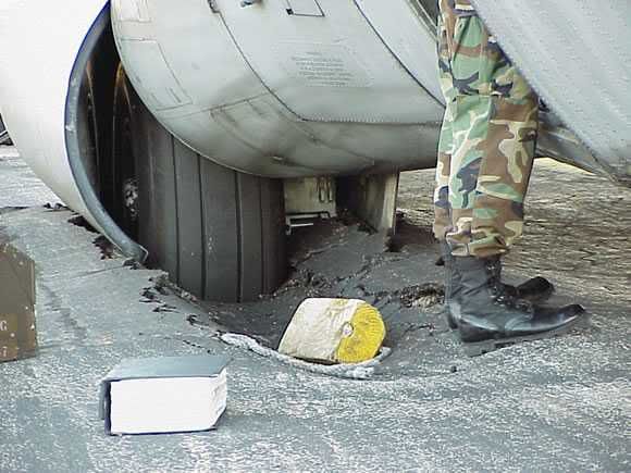

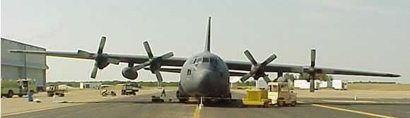

Four C-130 transports, full of dignitaries and other stuff, were flown
to Textron's airfield outside Dallas, for the roll out of the CV-22
aircraft.
The people arranging the ceremonies were warned that the runway could
not handle an aircraft as heavy as the C-130. These warnings were
ignored. See what happened....

The yellow thing on the left side of this picture.

That's a chock, not a chalk.

Yeah, I'll bet it could get itself out of those ruts with only minor damage to the gear doors. Herks are very good on unimproved fields.
I wonder if that damage was an instantaneous thing, or it took a little while for the asphalt to flow?

It's not the asphalts fault.....so to speak. Runways and taxiways are rated for their weigh bearing capability. Generally speaking, the smaller the airport, the smaller (and lighter) the aircraft using it will be. Hence, the runways/taxiways/ramps will be rated for lighter weights.
Contrast that with airports that handle "heavy" aircraft (currently, heavies are those more than 257,000 lb gross take-off weight), those runways will have a concrete underlayment several feet thisck. It is even thicker at each end of the runway were the aircraft touchdown. I visited Wright-Patterson AFB and I was told that the touchdown zones on the runways had concrete underlayment that was ten feet thick. The pilots of those Herky Birds should have called the airport ops before hand to see what the apron was rated for......

looks like hydraulics damage on this side

God damn, that is a heavy plane. I can't belive it literally crushed through the asphalt.

The ramps / runways at KRST are concrete and thus don't soften in the heat. I've seen 747's at Rochester before, and King Hussain of Jordan would frequently park his L1011 there as well. KRST is actually a good size airport, runway wise, and is able to handle most commercial airliners as well as military aircraft.

That was Addison Field in 2000.
Nope, that the APU exhaust door, that fluid is the APU engine oil that has leaked out / spilled during servicing and sits inside the compartment or under the APU compartment in a void.
Aircraft sinks down with a nose up attitude and the oil drains out.
Happens all the time when jacking the right side for main mount changes.

first, it looks like the herc was taxing in, if it was on the landing, a LOT of damage would have ensued... no way it could have stopped that quick... look at the length and depth or the ruts... probably hit a soft spot and sunk.

I have little doubt that powered up it'll pull its self out.

I'm wondering if it happened fast or slowly sank in...like a '59 Caddy on a hot day at a red light?
Looks like he rolled into it...with no turning back at that point.

They didn't have to call. Those figures are in flight planning pubs. Somebody's squadron is going to get a nice bill to pay from their OPTAR $$.

Look at the alligator cracking in those pics. That pavement could barely support the full on weight of a Cessna 182 let alone a C-130.

I think they put the wing and nose jacks on it, defueled it,, dug out the area around the main mounts and filled it in with quick set cement. I seem to remember that they waited until after the sun set. Then they towed it on out.
The C-130 couldn't have weighed more than 90,000 - 100,000 lbs. All the aircrew had to do was check the -1 for the Ground Floatation requirements and use the equivlant single wheel load index to figure it out.
Off the top of my head I think they probably should have lowered the tire pressures to about 60-70 lbs in order to keep from sinking into the runway.
