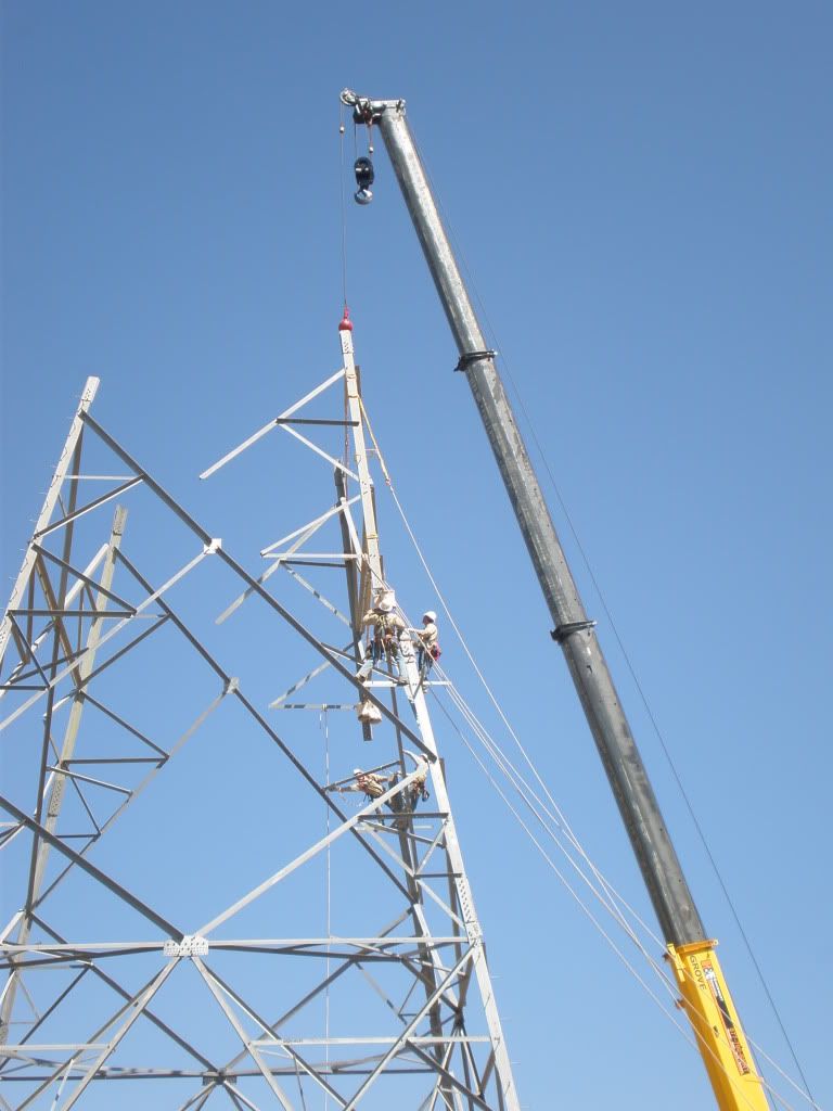

Who do you work for? I'm now a field engineer for T-line projects, but I was a design engineer for 5 years prior to this.
Current project

Originally Posted By SCW:
Originally Posted By THOLL223:
If by T type you are talking about the crossarm on the pole at the top and E type you are talking about laid out on the pole and spaced at different heights.
Usually they mounted them vertically to decrease the width of the line for tree clearance, keep it tighter to the pole. If they go back and forth for no reason, I am not sure some designer was drunk that day.
fyi: I design powerlines for a living
Current project
http://i981.photobucket.com/albums/ae294/SCW-Shooter/P9010249.jpg
