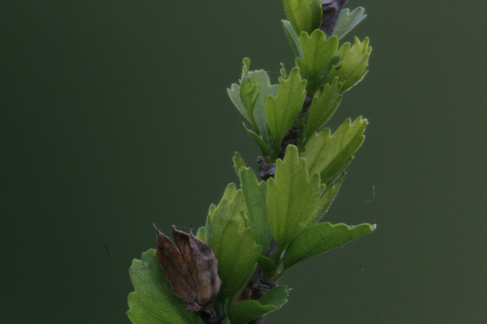

mfingar  [Site Sponsor]
4/5/2012 12:58:38 PM
I've had good luck with items that don't move (and stack all the time...especially with good light).
The quality will hold OK with good glass, but the autofocus suffers greatly.
Here's some unretouched examples...
600mm f4L IS was the base lens
600mm
600mm and 1.4X II
600mm and 2X II
600mm with both 1.4X II and 2X II stacked
and just for yuks...
600mm and 2X II
600mm 2X II and 2X III stacked (that's 2400mm).

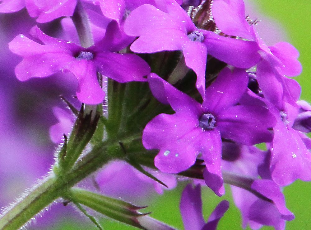

4/5/2012 1:55:19 PM
Originally Posted By PooFire:
So that last one is at what, like f/16 or somewhere around that?
Actually, the camera remained set at f/8...it did not recognize the extra 2X, (but was darker). I bumped the ISO from 640 to 2500 for that shot. It gave me an 1/1000 exposure.
Also.
There are many cases where just cropping/enlarging a file will do.
600mm enlarged
600mm w/ 1.4X and 2X
